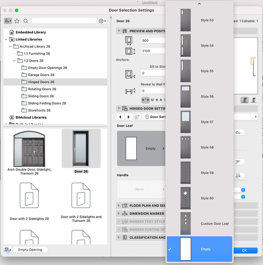

You can select an empty door leaf under the door settings:

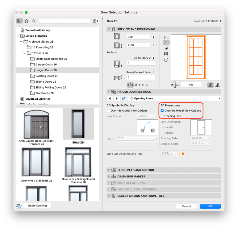

Step 1 - Hide the opening line:

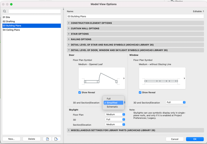

Step 2 - Change Model View Options settings, detail level of doors, to "simplified":Screenshot 2023-05-26 at 14.42.30.png

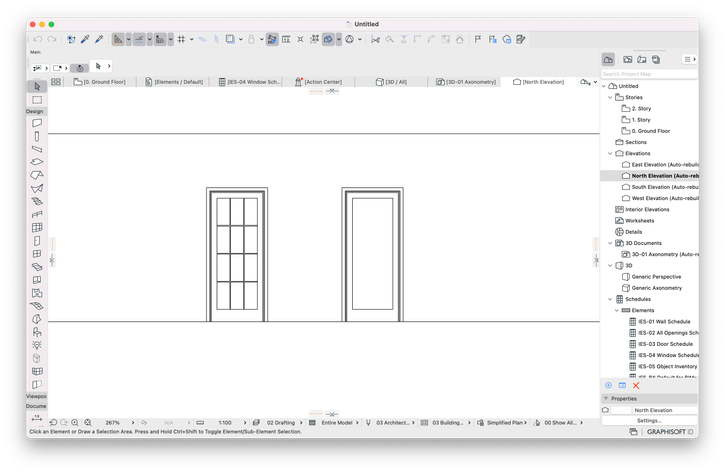

Result after step 2, with Graphic Overrides applied to display door surfices white:
