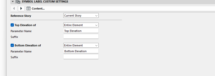

On any plan view, Is there any way to show 1st Referencing Level with the Elevation Label? I'm trying to show the top level of the retaining wall with 1st referencing level but it does not have any function. All it has is the Current Story. See screenshot attached.
Am I missing something?

No, it is a limitation of that label.

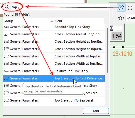

You could create your own with the autotext label.
