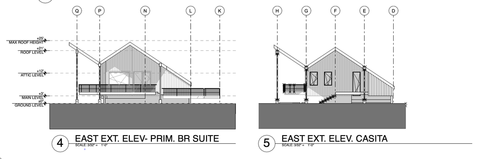

Here's what one elevation looks like that works and one that's broken.
Karl Ottenstein
Moderator Emeritus
The little x's as you call them are hotspots... which would only appear if you had somehow "exploded" the content of the elevation.  An elevation being on auto-update vs manual would have nothing to do with those appearing.
It appears that at least your beams and columns have been exploded.  Exploded content is no longer linked to the model but is 2D linework, fills and hotspots (x's).  Click on one of the lines for the column or beam and see if it doesn't show it as a line or fill vs an actual column or beam?  I'm guessing that what was an elevation is not an independent worksheet.

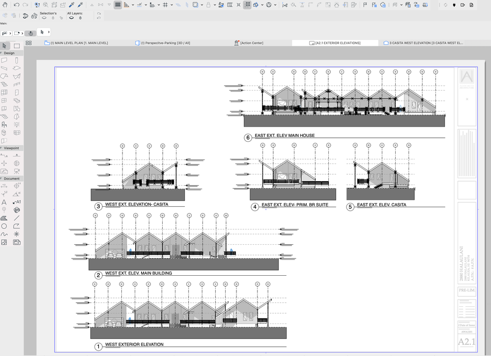

The part that remains, is that the "hotspots" associated with the corners of structrural elements and railings remain.  I can't seem to select them or turn them off.  They don't print so it's not critical, but I'd love to figure that part out too.  See below for image of my layout AFTER the markers have been set to source.  Elevations 3,5, and 6 have been fixed but retain the hotspots.  elevations 1,2, and 4 never broke.

DGSketcher
Legend
@Adam_Weiss I think the problem is the source view is now merged with linework created by the changed marker type. You could open the elevation Source View in the Project Map, turn on all layers and run Find & Select for all “2D Elements”. Check it hasn’t selected anything you want to keep e.g. annotations, if it has then remove them from the selection and then Delete the remaining selection. You should then be left with a view of the model and any 2D elements you wanted to keep.
This is rough editing so make sure you keep a backup file in case you delete something you need.
Adam_Weiss
Thank you!  You were right.  The 2d info previously created was still there.  Just had to select it and delete it as you said.  Thanks!
