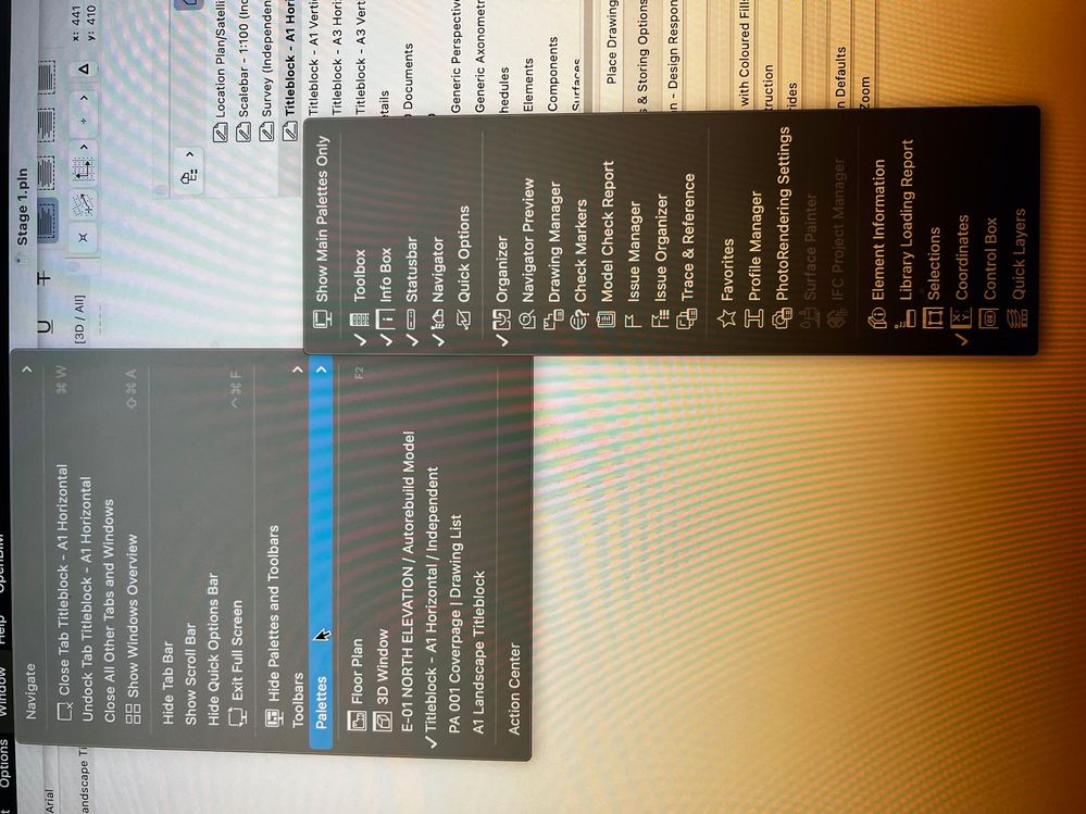

Harleyv
Thanks for the reply David. Only problem is I do not appear to have that in my dropdown menu - see attached screen shot.
Is there another way to skin the cat?
Thanks again.
Harley Vincent Architect
AC SE2021 AU . MacBook Air M1 OSX 14.1.2 16 gb ram

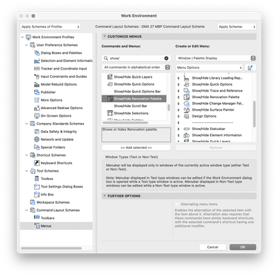

Seems like you are using a Work Environment imported from an older version of Archicad, that did not have renovation filters.
You can swap the WE to a default one that comes with the version you are working in, or you can customise your current WE and add the command in the menu.
There will be many other commands missing as well, so you are better off using a default WE and then customising it to suit your needs.
