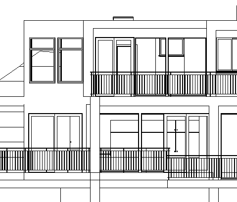

Elevations printing with see through windows - not good
Something got changed in my elevation drawings and now when I go to plot everything through the window glass is visible in the back ground. How do I change it back to non see through windows?
Thanks!
see image...

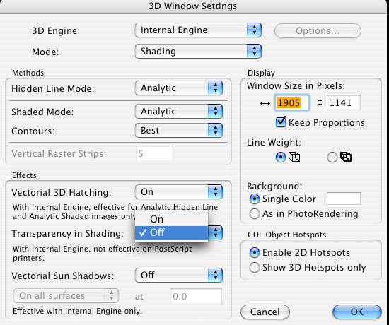

Check your 3D window settings. They also effect your elevations.
I have assumed you are using 10.
If you add your OS and AC version to you signature it helps with a more informed answer
Set "Transparency in Shading" to Off.
