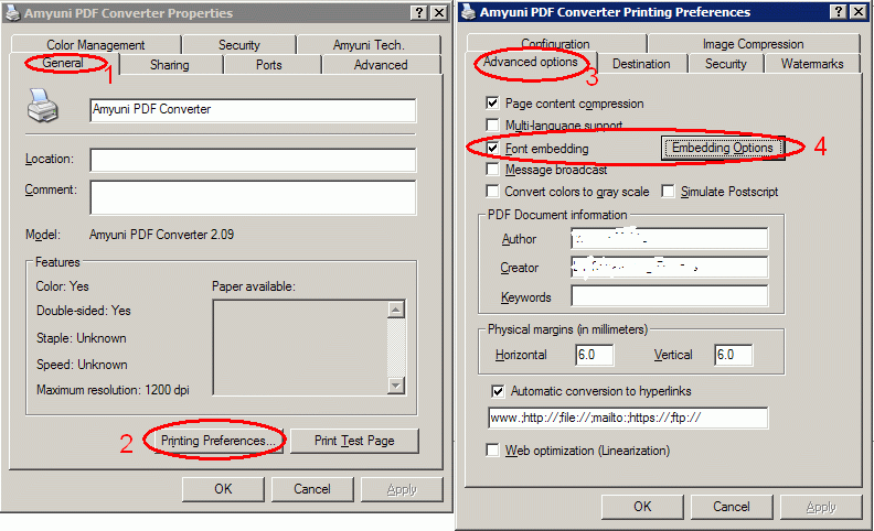

vistasp
Are you using Amyuni for this?
Go to Control Panel > Printers & Faxes & right-click on Amyuni PDF Convertor. Choose Properties.
1. In the General Tab, click on
2. Printing Preferences button and then look in the
3. Advanced Options tab for
4. Embedding Options.
Have attached screenshots - hope they help.
