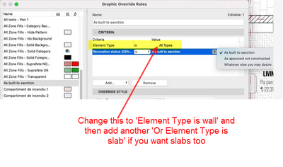

You can't do that with the renovation filter, but you can do that with Graphic Override. Just go to property manager and add a new property, i named it renovation status. Then set data type to option set, then click options setup and add as many options as you want. Make sure your property is available to all classifications.
Then, go to Graphic Override combinations, create a new combination, let call it by the same name, Renovation Filter. Then click on edit rules. Add a new rule, let's say for the first option of the option set, As built to sanction.
Add a new criteria citing the previously created property. Check the line/Marker/Text pen and select the new color. Repeat this step for every other item in the option step, then add all of these rules to the previously created GOC.

Hi again,
Last time I thought that I did it or maybe now I am doing something wrong. The problem that I am having now is how to apply 'Graphic Override' only to walls, slabs and other stuff that are 'As built to sanction'. Because when I am applying the Graphic override, all stuff are changing colors not only walls that are 'As built to sanction'.
In other words I want to select 'Graphic Override' for only 'As built to sanction' walls and only those walls turn into blue and not all walls.

You have to set the criteria to filter for the elements you want to affect.
Hi Barry Kelly thanks for your reply. Yes I changed Element type to Wall and it's OK. But how can I apply only to 1 or 2 walls instead of all walls? Because like this all walls are changing colour.
