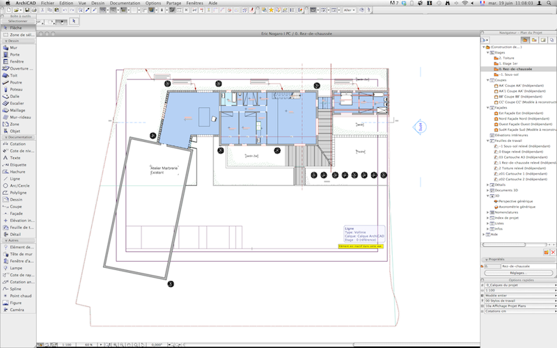

Well, I just tried last week to use the ArchiCADs internal print layout options to set my File which I'm usually use to do on InDesign. I didn't use this abilities before and I just (by no idea how) make the layout appear on the main project pages including level. ( The working space). By default, the layout is shown on screen, in violet (as seen on the screen caption)
I'm absolute not able to kick off this layer out from my view! The "object" is locked, obviously I can edit it on the special page but I can't nor edit, move or delete it on the main page (the working space)! I even do not understand how I could center the maps in the layout...
Anyway, I want it to be deleted...

What it seems you are seeing is that the layout is set as your "Trace Reference". Simply turn off the trace reference and you will see your model as you expect.
