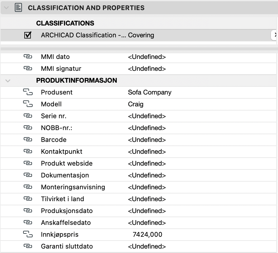

Is there a way to generate a list of the objects used, including the amount of each object, and the information assigned in the "product information" under "classification and parameters" tab in the object settings?
I hope to enter product name, supplier and price in this tab, and then easily export a list of all i.e. furniture I've used.
Tips?

You may want to look at this link to get you started... Interactive Schedules

@Konsis wrote:
Not new to Archicad at all, just never worked with lists before.
Be careful of the terminology used.
'Lists' are something a little different - old method used before we had the 'Interactive Schedules'.
They still (sort of) work but are no longer being updated - so don't work with any of the new tools.
