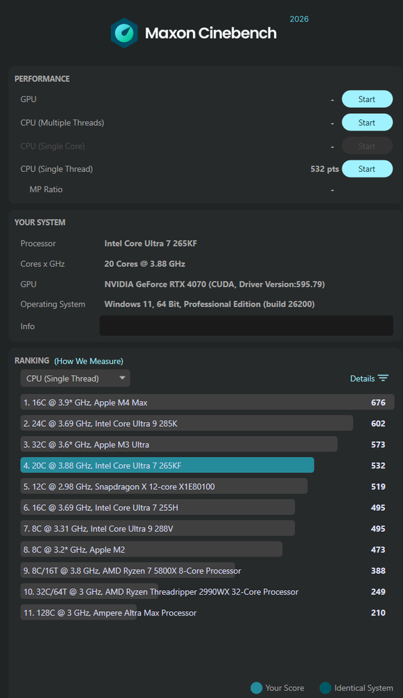

Hello, can somebody please solve my problem. I have fairly complex model of historical building with a lot of morphs/objects on facade. So I expect it to run a bit slow. But it is simply extreme on my Intel  Core 7 265K + 64GB RAM - which should by quite powerfull. Rebuild from model takes around 10min. I tested the same model on Ryzen 5 7600 32GB RAM and it takes only 2min and on MAC M5 16GB RAM it takes only 1min and 30sec. Is this arrow lake Intel really so bad CPU? Thanks in advance.

Weird thing is that I ran Cinebench 2026 test and the results were very good.
So the CPU is working as expected only this specific task in archicad is problem. Every other operation in archicad is flawless.
