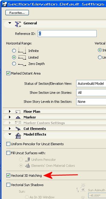

I'm talking about the check box as in image below, from Section / Elevation Tool settings. (Image from AC10 but this setting is same in AC9)
Thank you.
You were right, there was a "vectorial 3D hatching" check box in fill options, and obviously it wasn't checked. Slightly missplaced in my opinion. I couldn't guess it could be related to elevation views. Now I know better.
