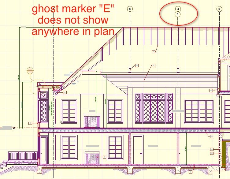

Just wanted to see if anyone else has run into this anomaly..
Somewhere during the course of this project, I picked up a GHOST GRID MARKER in ONE of my sections.... Shown below...
1. Marker shows and prints, but does not exist in plan
2. Yes I do have an E grid, but its going the other direction
3. In section, it says this grid cannot be edited except for in plan.
4. At first, the info flyout said it was "home storied" on -5, today it says it belongs to -2..
5. I can drag a new section and it is not there (don't really want to re-embellish, but whatever it takes)...
Just wondering if it's only me.

Is this project in 14?
Was the project started in an earlier version?
This looks like some of the rogue marker problems I've encountered in AC12 and/or when I've migrated a project to a newer version of AC.

Project started in 13.. but no grids until 14...
