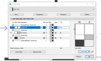

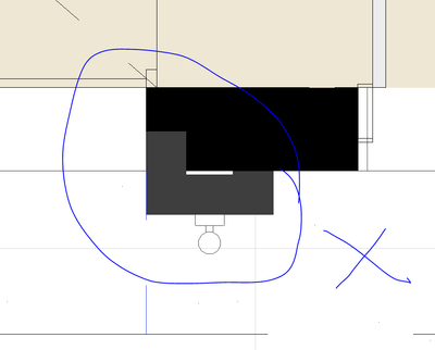

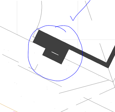

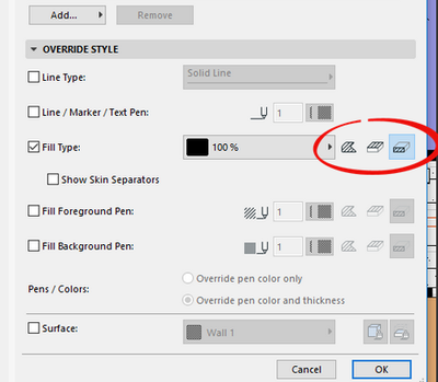

The above fill 'Ëmpty FIll' is used in two wall types but is for some reason showing differently in one project. I want it to show as below - all black. However, it is showing as grey in the third picture for one of the walls. I cannot see a difference in the GO settings or the MVO nor the attributes of the actual walls. And there shouldn't be as the drawings are all from the same template...I know it's something simple because I've fixed it before but just can't recall what it is again. Any help is appreicated.

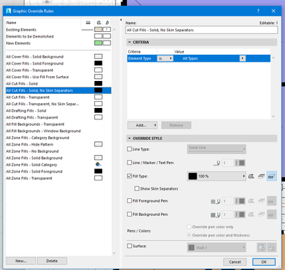

Without the Graphic Override, the fill colours are controlled in the Building Material settings.
With GO, it depends on the criteria you are using to filter the elements.
Maybe it is selecting one element (say walls) but not another (say columns).
We would need to see your GO criteria settings.
Ode1
Thankyou Barry, do you mean the below? It's very basic.
It must has something to do with the individual wall fill as I have just noticed that a smaller unit type doesn't have the same issue which is strange because they were used to produce the larger buildings. It's something I have done somehow. I'll keep looking. The pic below shows two drawings made from the original base pln. One is good and the other not. Thankyou for your help.

You are only overriding the cut type of fills.
Maybe also choosing drafting and surface fills will help?

Ode1

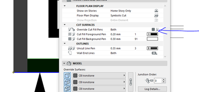

Barry, I found it!  I didn't have Override Cut Fill Pens - Both selected...that doesn't answer my template issue but at least I know what to look for.
Thanks again for trying to help.

@Ode1 If you want a consistent appearance then you need to set the pen override as well as the fill pattern, Your GO doesn’t set the pens so the appearance will be impacted by other pen settings in the element.

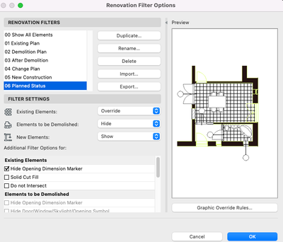

This might be a long shot but have you checked the element's Renovation Filter Status? 'Override' must have been selected in one of the filters as you've mentioned this is coming from an existing base pln.

Ode1
Thankyou for replying. I did finally find the issue -
I didn't have Override Cut Fill Pens - Both selected -
So, if that's what you meant I found it. 😊

Ode1
Thankyou danielleL for replying. It wasn't a GO issue it ended up being that I didn't have Override Cut Fill Pens - Both selected...I've fixed it now.
