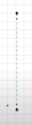

Hi All,
I'm having issue with extending gridlines - from what I can see online people have two pink dots for controlling staggering, and extension of gridline head e.g. image below:
However the one I'm using at work has only one of it:
Is it to do with some settings? I'm so confused as I can't just extend gridlines by dragging it - it just staggers instead.
Thanks in advance!

cs_ryl:
Probably, the Extension and Stagger hotspots are on top of each other. Select the Grid Line, open its settings, then go to Floor Plan > Staggering and change its value. This should reset the hotspot locations.

Thanks @David Maudlin ! That was it.
Great tips on adding details! Already updated mine! Cheers!
