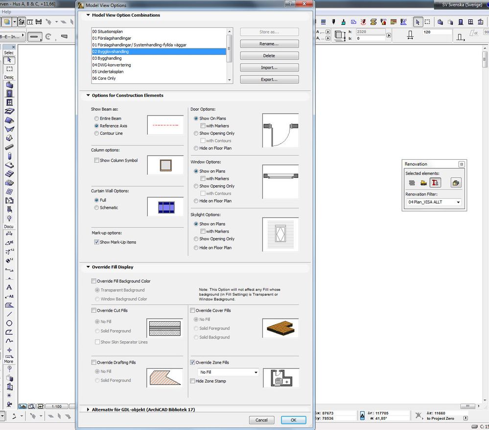

As an archicad user of several years of experience I normally do not run into problems I cannot solve. However this problem one has taken almost a working day and still was not able to solve. I have attached 6 screenshots to aid in explaining the issue.
I am attempting to override all of the new (renovation type) walls with a hatched fill style. Instead, I get a solid black wall (see first screenshot in the attachment). The two upper walls are demolished and existing walls, and are not part of this issue (we want them to look like that).
It happens despite that I have double triple checked any other settings that could affect the cut wall visibility including renovation filter options and style (screenshot 2), model view options (screenshot 3), view settings (screenshot 4), and work Environment (screenshot 5).

model view options are correct (screenshot 3)

Did you ever get to the bottom of this problem? I am experiencing exactly the same thing but in version 18
I am not seeing this in 18 (haven't checked earlier versions).
What is the spacing of your hatch pattern?
Is it set to 'scale independent' or 'scale with plan'?
