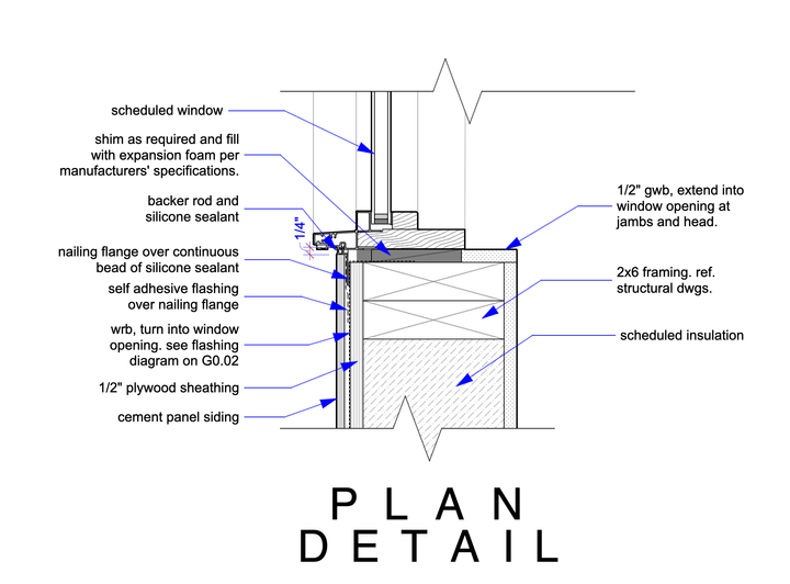

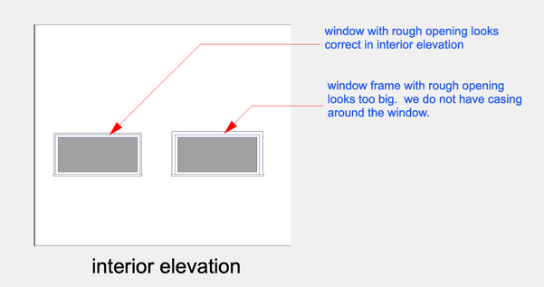

I've modeled two windows next each other, one with a rough opening in the model element and the other without out.  Attached is this detail in plan view, exterior elevation, interior elevation, and a detail (drawn with linework) that shows how this window connection is constructed.
Ideal world would be if we could see the rough opening plan and then hide it in elevation and interior elevation.
