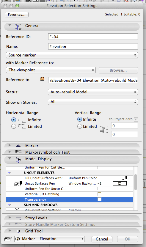

Thanks for the reply but when i uncheck the transparency box I can't click OK. (I can't click OK even if I don´t uncheck the transparency box)
Something seems wrong with the elevations settings...
Do you have any idea?
DGSketcher
Legend
The elevation marker layer is probably locked.
YES! That was the case! Thank you so much!!
