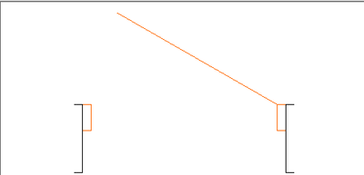

I meant the black lines that show the movement of the door edge. I need to disable them. In the photo, I changed the color of the line, but I need another way.

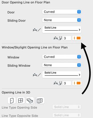

Hi @Oleksandr Konopliuk,
As Gordana guided you to control the door opening line (Globally), it’s type & color.
As pointed out by the arrow in the attached image.
But for the individual door, AFAIK I think you can’t control it.
