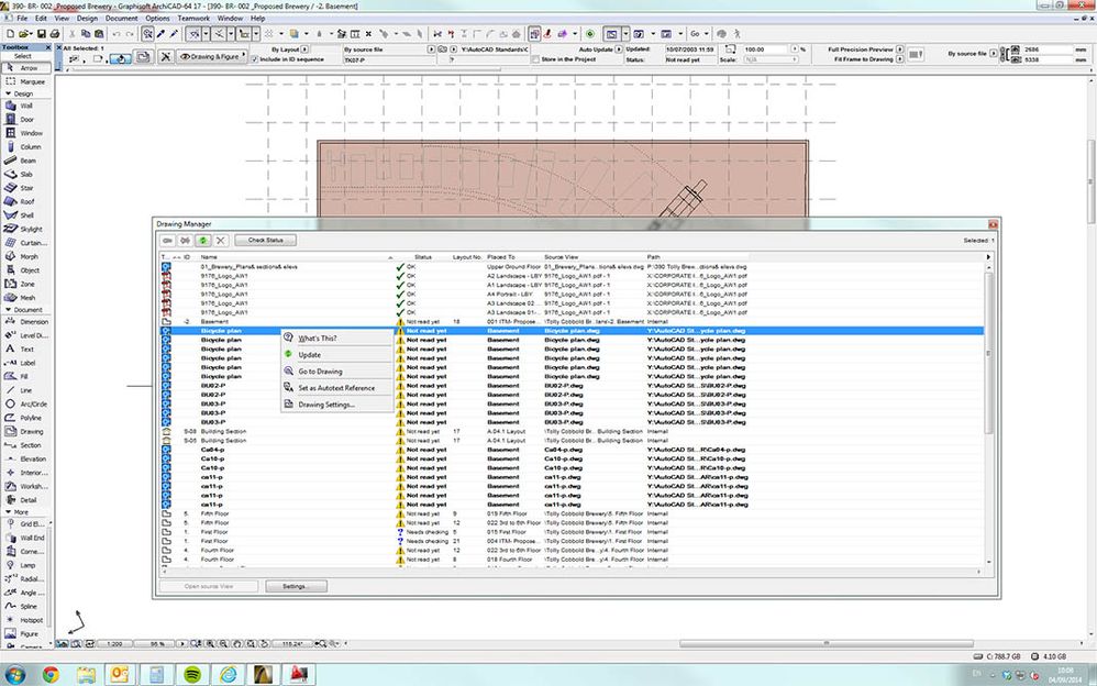

I have a few DWG files placed in the drawing. But now they don't show and there's only a gray lined box around where they used to sit.
Drawing manager shows their status as NOT READ YET.
And when I update nothing happens.
I have checked if they are on an off layer but that's not the case. Also I tried placing one of them again and it shows well in the drawing. Only the existing ones don't.
It could be that they have been deleted by accident. However, if they are still on the Drawing manager's list, is there a way to update/re-linke them so they would appear again?

Yes, select the drawing (or its name in the Drawing Manager), right click on it and choose 'Link Drawing to..."
It sounds like your original source DWG files were moved (or deleted as you said).
Thank you. But when I right-click I do not get that option. Yesterday I ended up dropping the DWG files in the drawing again, once I had done that, the rest of them started to recognize it and automatically showed up again and were re-linked.

I get the 'Link Drawing to' option.
The 'Update' option should work if the file is in it's original location which it must be otherwise it would say 'missing'.
How did you place the DWG file?
Was it with the Drawing tool?
Funny enough, when I change my layer combination from prelim to Render, the DWG elements show! And in the manager I can right-click and re-link option is there!!!!
Yes if the layer the DWG was placed in is turned off then the 'Link to drawing' option is not available.
