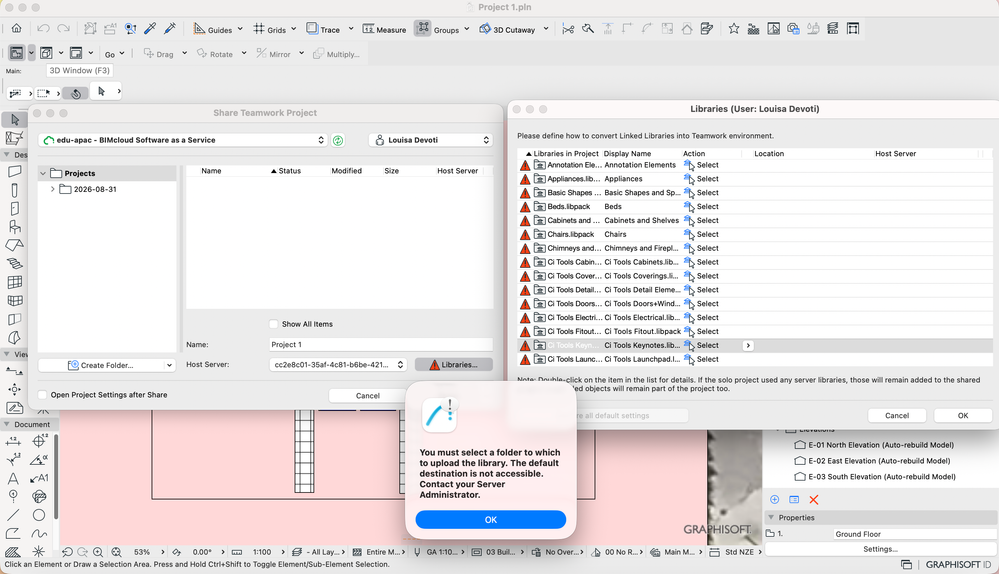

Hi there,
I am currently a student using the education license, and am wanting to collaborate with 3 other students on a team work file. I have obtained a EDU BIMcloud team, which I am the leader of. However when I attempt to go Teamwork -> project -> share. It comes up with a red alert stating: 'You must select a folder to which to upload the library the default destination is not accessible. Contact your sever administrator.' (See photo below)
In my regular library manager there are no missing libraries as I have been successfully able to relink everything. The red alerts are for both my CI tools plug in and regular archicad elements. I am unsure what to do from here as I have watched videos and read on the forum on how to create a team work file but I haven't been able to find a solution for my error.

In the Share Teamwork Project Dialog, try the "Create Folder" button to create a folder on the BIMcloud server. Then select that folder in the list. Then, hopefully, you will not receive this error message.
