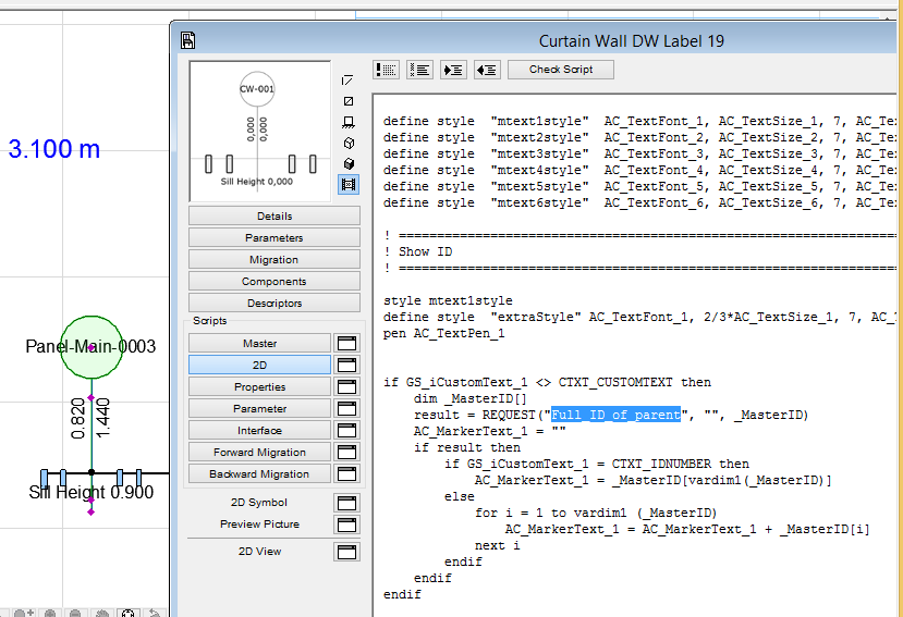

I assume the reason this was not finished is it is tied up in the general implementation of RW access to IFC parameters from within GDL?Note: As with other elements, the Zone ID is extended by the Master ID of the module instance it belongs to. Optionally, connect the Zone ID with its Zone Number and display it in the Zone Stamp.
• For example, a Zone with an ID of Bathroom in the source file is placed into the host file as part of a HLM with a Master ID of R213. Its Zone Number will then be R213Bathroom
2014-02-05 10:25 AM
