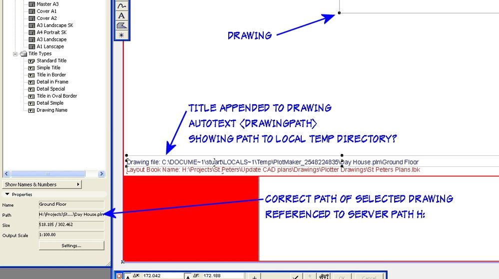

I am trying to reference the path of an imported drawing, using Autotext <drawingpath> which is contained within a title appended to my imported drawing. It is referencing my C:\...TEMP\... folder rather than following the path to the server H:\Projects... as shown in the attached image. I have checked that the PLN is actually in the correct H:\Projects folder, and this happens whether or not the PLN is open in ArchiCAD.

If you look at the screenshot on my initial post you can see the correct path displayed in the navigator (bottom left), and the path to the Layout Book name is correctly referenced to the server location H:\ (below incorrect drawing path)
S2art, you are using the incorrect autotext reference.
Try using <ACFILEPATH> instead of <DRAWINGPATH>. When you use <ACFILEPATH>, this references where the LITERAL 'working' file path is; this resides in your temp folder (or where your temporary work environment is set to in windows).
Note that <ACFILEPATH> will only work correctly as autotext if applied to a Title Type. If you simply place <ACFILEPATH> in your layout, you will need to select a drawing at SET AS AUTOTEXT REFERENCE.
I'd recommend using <ACFILEPATH> on a Title Type, this would make it automatic without having to set the autotext reference.

Thanks Chad, that makes perfect sense.
I was applying it to a title, so will continue along that path (pun intended).
