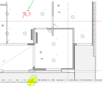

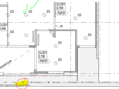

Hello,
Rather than retracing all ELEC documentation provided by our service engineer, I import his DWGs as a drawing, edit its layer combination and appearance and place it on my RCP views.
I got different RCP scales, 1:100 for general RCP plans, 1:50 / 1:20 for zoomed-in zones (like a zoom on kitchens)
That works completely fine at scale 1:100 (the scale he's been exporting from Revit or AutoCAD I assume) but the 1:20 scale for instance looks stupid. The symbols remain the same and the text adapts to the scale. See below
1:100
1:20
I can see only one workaround, ask the consultant to provide me with DWGs scale 1:20, and have a different layer combo or my RCPs to have the right DWG on the right scale.

Vincent G
Hello, thank you for the reply.
My problem is that the symbols don't scale like the text, so at 1:20 I got huge symbols covering all the view and the text appear tiny but that's how it should look like.
I could indeed explode the dwgs and do some re-work, but whenever I receive an update from the engineer, all the work would need to be done again rather than just swapping one DWG to another.
I better then re-trace all his doco with AC scalable items, but again we lose the purpose of quick update of the documentation.
