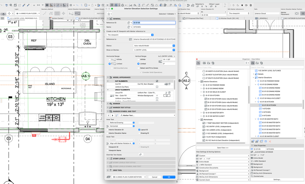

Int Elevation marker - outer text greyed out, not displaying
Hi all,
I've been trying to trouble shoot —don't know how, when or why the outer text on this one marker disappeared in plan view and is greyed out in the Selection Settings dialogue box. I don't find any settings that are differing from other markers that are displaying correctly.
Found a similar post in forum search but no solution.
Dan

This is a bit of a guess without starting Archicad up.
I would say it is because of the marker head style you have chosen - it does not have the outer text or direction triangles.
See the one to the right (A5.2 - ABC) and look at its settings to see what marker style is used.
