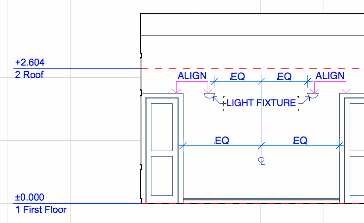

Sigh.. No good..
This was the first thing I did. I can give it 10,000 decimal places, yet it still sits on one..
Attached is a picture. This shows the main problems I am having.. Firstly, the levels should be 99,510 and 102,510, rather than +100 and +103. This is unchangable through any of the settings..
ALSO!!!! these stupid elevations keep intermittently swapping from the nice black story lines with nice and correct offset from the edges of the elevations, to the ugly blue lines with ridiculous placement of text over drawings. Excitingly, this is inconsistent as all interior elevation markers are EXACTLY the same, AND they randomly swap around, so when I update all drawings, some might randomly be fixed, but another will take on the problem.
I know people like saying things like "your fault, ArchiCAD is perfect", which is true sometimes, but this is the stupidest thing ever to not be my fault..

NickMcLeod wrote:
Sigh.. No good..
Works here. If you post an image of your Dimensions Settings and your View Settings maybe someone will see the problem. I don't know where you can set anything in ArchiCAD to 10,000 decimal places, in the Dimensions Settings, using meters, the maximum decimals is 4.
