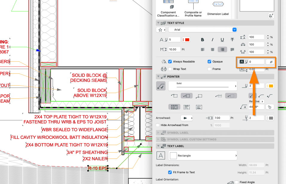

Suddenly, not all of the labels with the opaque option checked are working to block out the background.
Attached below are two screen shots, the first one shows a label with the opaque option not working and the second shows the label where the opaque option is working. I've started copying the label that does work which slows things down.
Any suggestions

Hi @Quirk
Try changing the pen for the opaque frame to screen background or white color because you have it selected as transparent background.

Ricardo Lopez
Hi @Quirk
