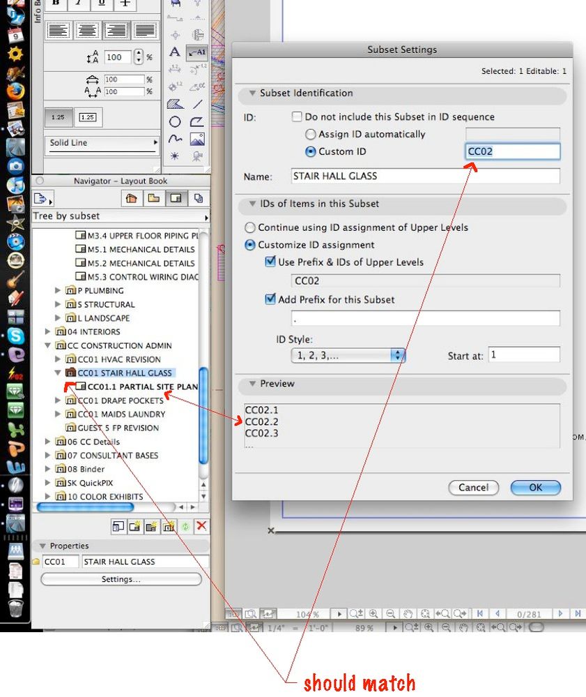

All of a sudden I can't rename my Layout ID's... I type over the ID and it just switches back... The Governing Subset should automatically put this number there, but it doesn't.
I did COPY one subset to make the others, but the settings suggest it should auto number.
I also tried creating a new one and same deal.
I am sure I'm missing something easy.....

Shouldn't that be set to 'assign ID automatically' in order to pick up the auto numbering from the parent subset above?

Yes it should, but that did not work either... in fact it shows NOTHING in the little box in the dialog yet the subsets all remain named CC01

The 'CC construction Admin' folder should have a Custom ID of 'CC' with 'use Prefix & ID of upper levels' ticked and an ID style of '01,02,03...' for subfolders to increment correctly.
The 'Stair Hall Glass' folder should have 'Assign ID Automatically' ticked, 'use Prefix & ID of upper levels' ticked, and 'add prefix' as a decimal point, then ID style '1,2,3...'
Seems to work for me?

All of my other subsets are working fine.... I must be running into something out of the ordinary. Files getting big.....
Even changing to MANUAL the ID's will not change from CC01.

I think I figured out the solution. I had to change the book settings to "use hierarchy".

Very similar problem here. Trying to overwrite Layout ID with a Custom value -- the Layout Settings dialog shows the correct Custom ID, but the Layout is not renumbered (neither on the sheet nor in the Navigator). This is a TW file.
