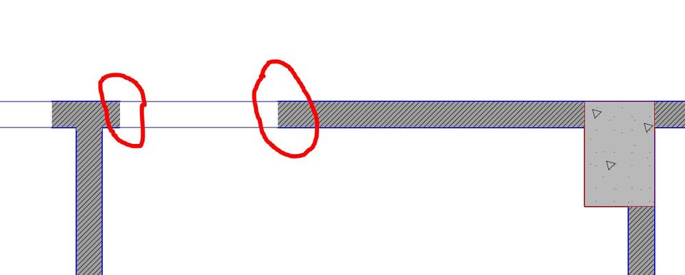

Hello everyone,
I am creating a Wall Layout Plan and I want the walls to be completely enclosed by a blue outline. I have set the doors to "Show Opening Only" in the Model View Options (MVO).
My issue is that the contour lines at the ends of the wall openings are missing. The blue outline does not enclose the wall ends where the door opening is located (as seen in the attached image).
What I have checked so far:
  • MVO > Construction Element Options > Door is set to "Show Opening Only" and the "with Contour" box is checked.
How can I ensure the blue lines close the wall ends at these openings?

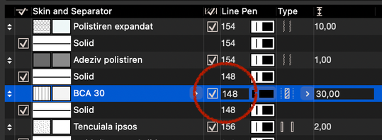

Claudiu Serban
Works for me with just the MVO settings, it must be something on your end. Is that a wall composite? Make sure that checkbox is on and use the same blue pen on it.

Cazer_36
Spot on. That was exactly the problem. Thank you for the solution.
