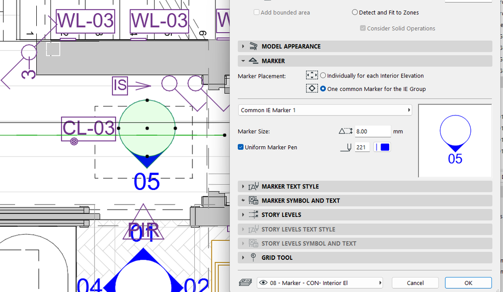

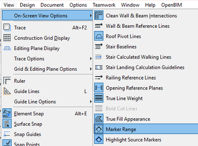

how to remove  marker arrow from the symbol and from the views - I'd like to keep only two internal elevations views and to have a symbol reflecting it in the plan.
Also once removed, is it possible to add a view to the existing marker?
Many thanks in advance!

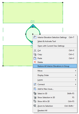

you cannot add views to a single marker later, but you can place markers over top of each other to look like they are part of a common marker.
if you have a common marker then you can delete views,

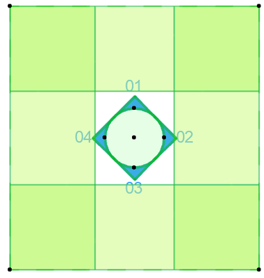

turn on "marker range" and "highlight source markers" so you can see the internal elevation views
under view -> on-screen view options->
you will then see your views highlighted

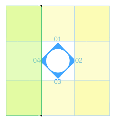

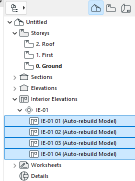

you can select a view
and delete it (using the delete button)
select another view and delete it

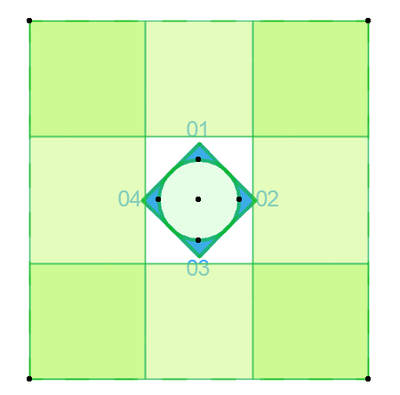

 to get views back that have been deleted, select the marker, right click and "Restore all interior elevations in group"
NOTE: any dimension/notes/2d content etc. that were in the view when you deleted the view are lost, only the 3D model elements are in the restored view.
remember to turn "marker range" and "highlight source markers" after you have finished editing markers, or your view will be very confusing.
I hope this helps.
