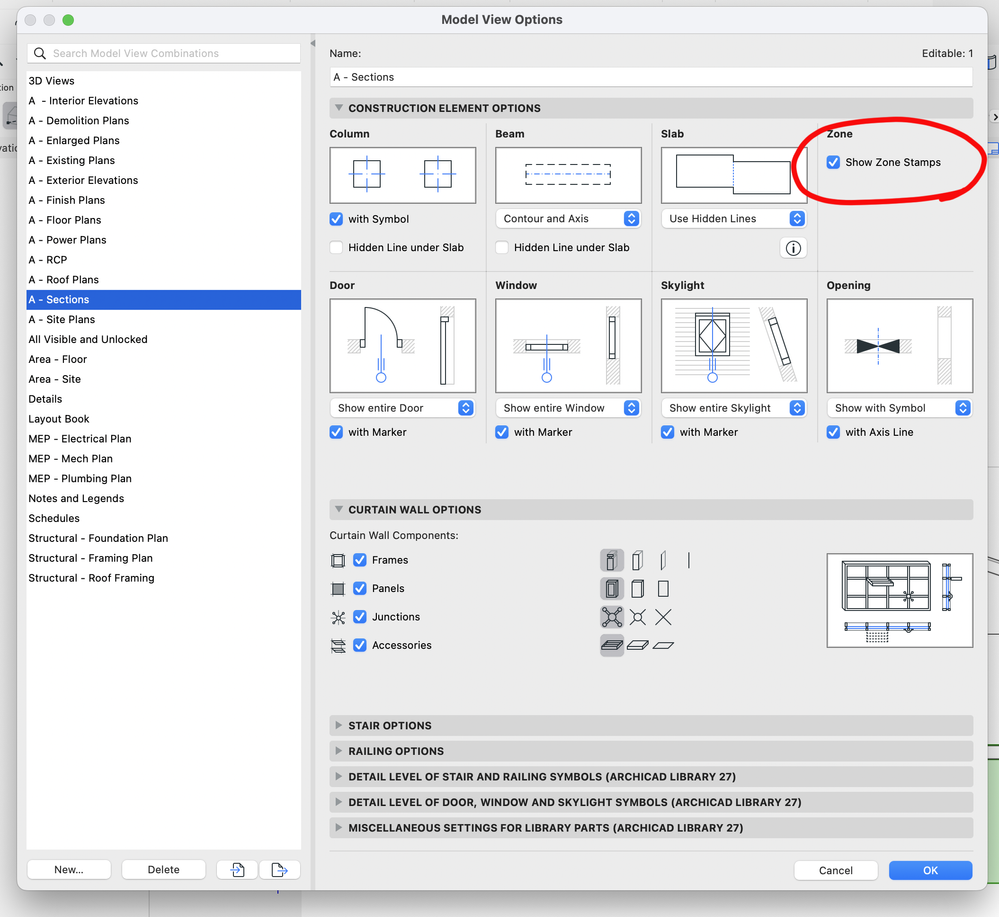

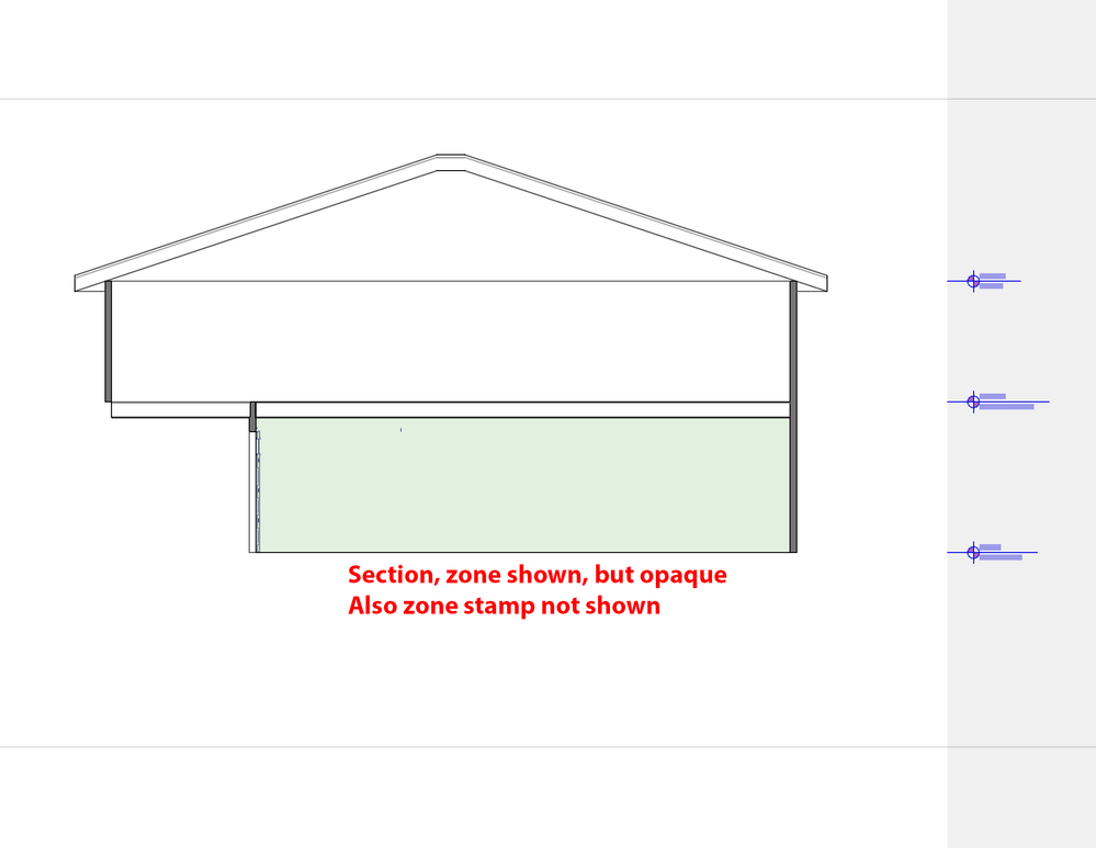

I can't show zone to be transparent in cross section.  and also room stamp won't turn on
all layer turn on.
renovation filter is show for existing, demo, new.
no graphic overside combinations.

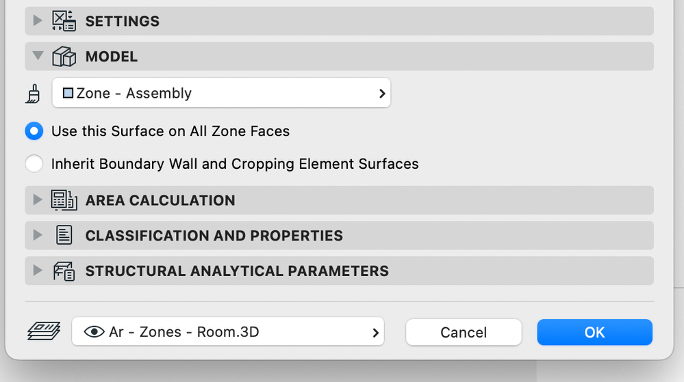

Model View Option: show with zone stamps is on.

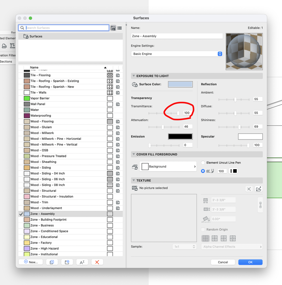

Zone surface is Zone Assembly.
Zone Assembly transmittance is 100.
but I get cross section opaque without zone stamp.
I read thru AC27 Manuel and find nothing else I could did wrong.

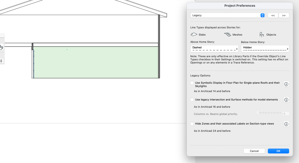

zones currently do not appear transparent in section or elevation.
try this workaround:
https://community.graphisoft.com/t5/Documentation/zone-transparency-in-section-w-label/m-p/334616
this is pretty much how we do our zone labelling in section, elevation, internal elevs.

Gerry, I checked that post, it apparently did not apply to me since I am already unchecked that option.
It is quite frustrating with those in AC.  I never had any problem before when I switch from auto cad to revit.

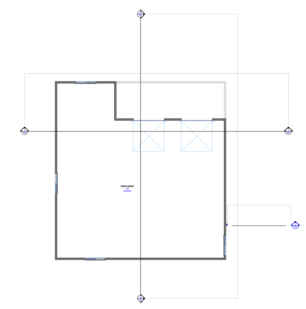

  • you're meant to temporarily turn on the zone
  • you don't use the Zone Stamp. use the Label Tool to call up the zone name
  • set it to layer set to a visible layer in your combinations (Elev/Sect notation) & ensure that the option set to "Hide with associated element" is un-checked
  • re-enable your usual Elev/Sect layer combo view. this will turn off the zone, but retain the Label Tool that calls up the zone name.
we rarely use the zone stamps anymore, as we can use the label tool to grab the same information that can be displayed in the zone stamp.

Zone stamps are only for plans - the old way of doing it.
Zone labels can be used in plans and sections/elevations.

In section you either need to turn on of the zone layer as Gerry suggested or use a Graphic override to make the zone transparent (and the layer can remain on).
Well, then AC need to drop out this feature from their Manual.  I know there is so many way I can get around, that will defeated purpose of BIM.  Screenshot 2023-11-19 at 5.56.46 PM.png

The automatic transparency does work if you have transparency turned on in your section.
But this affects other elements such as windows and glass shower screens.
If you are happy with those being transparent as well then all is good, otherwise you have to start using materials in those elements that are not transparent.
