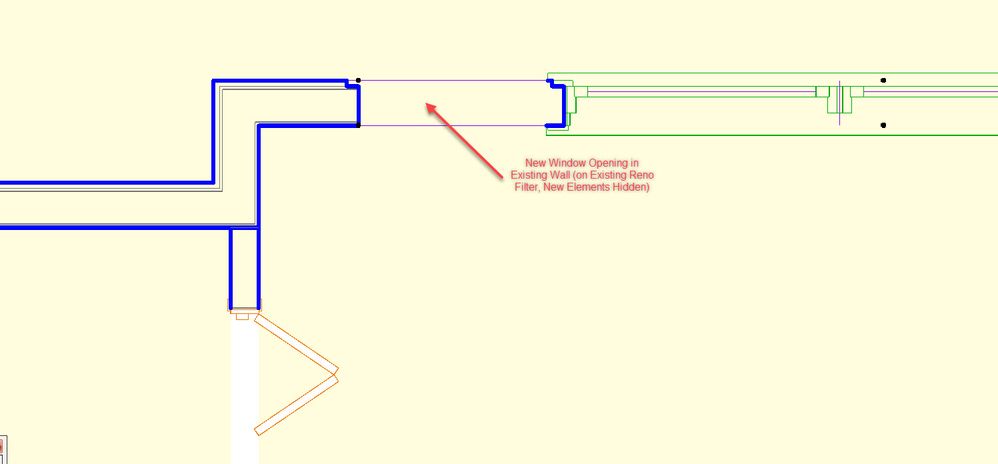

When I have an existing wall and put in a new door/window, the opening-to-be shows up in the existing plans/on the existing reno filter with my lightest line pen. (Rather than keeping the heavy pen of the wall.)
In my reno filter options, the existing filter is set to HIDE all new elements. It shows up anyway.
I've played with a bunch of graphic override rules and combinations, but haven't been able to solve the problem. I can't find anything in there, or with the building materials or composite that would suggest the light line. It shows fine in the demo reno filter and the new reno filter.
Any help would be appreciated-- our office has been struggling with this one for a long time over a few different AC versions.

dea0625:
Try setting the Elements to be Demolished to Show, this should retain the existing Wall as original (no opening).
David
David
