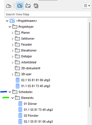

I recently installed archicad 26 and I'm using the swedish-standard start-template.
When I started a new schedule over in the projectmap it used to create a copy of it over in the view map but with this new version/start-template it no longer does. I have to manually "save the view" in the "organizer".
This is how it looks in the projectmap:
This is what it looks like in the viewmap:
In archicad 26 the schedules/elements are sorted into a regular folder (blue and green marking)

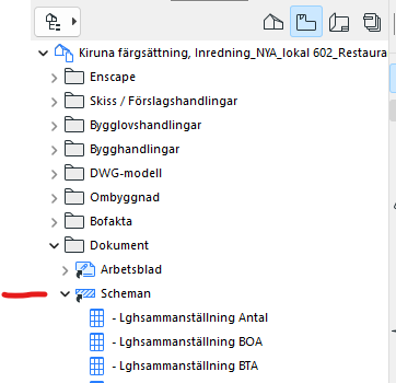

In archicad 25/my previous starting-template it used to look like this:
The blue icon with a small black arrow on it (marked here in red where "scheman" means "schedules" in swedish) was there but in the newer versions it has disapeared.
What should I do to get it back?

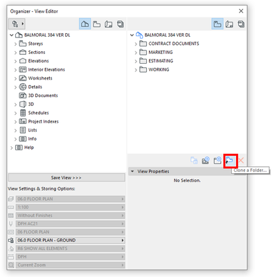

The Arrow on the icon is the Folder clone function (everything in the project map folder is replicated in the View Map)
Go to the organizer and select the View map on the right column,
or the Navigator View Map
Click the "Clone a folder" button

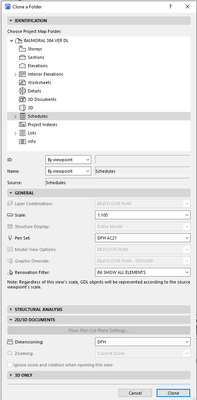

select the folder you want cloned (i.e. schedules) and the view settings you want for those views
now any new schedule will appear in that cloned folder automatically, with your selected settings.
