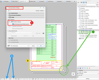

Hello,
Is it possible to insert our company logo on the bills of materials?

Hi Basille,
Can you clarify your question a bit:
Are you looking for a solution to embed an image into the header cell of a Schedule?
Or something else?
Cheers!
BASILLE
Hello, yes, absolutely, I would like to insert my company logo into a header.
Benedek Gaszpor
Hi Basille,
So, in the standard Schedule view it is not possible to insert an image to the header for example.
The best way to achieve what you are looking for is to place the saved view of your schedule onto a layout and set it to "Split Drawing among Multiple Layouts".
Then you can set the frame of the view to fit on a layout and then the parts that would be cut of, will be arranged with a same cut-out on new pages.
(A)
This way you can put your company logo and other important info, as you would on a drawing layout.
You can create a specific Layout Master, with the proper title block you desire.
(B)
When you activate this option, notice, that in the Layout window it indicates that this is a multy-page layout.
Moreover, on the navigator you can see how many pages is included under this multy-page layout.
(C)
You can then flip through the pages with the navigator arrows at the bottom.
But, be aware that with these you can navigate through all your layout book, not just the active multy-page layout.
(D)
If you need some more info regarding this workflow, you can check out this Graphisoft Support article:
How to split a schedule along multiple layouts? – Support site
Hope this helped 🙂
