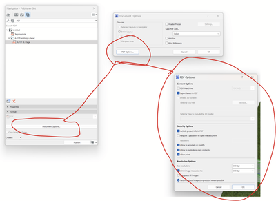

I´m not sure whether this has already been tested, but one should definitely print/publish from the AC Publisher set, the build in pdf printer is very good at compressing, nad there´s some settings that can be adjusted... This usually creates much smalle pdf´s than the common pdf printer e.g Microsoft print to pdf!
