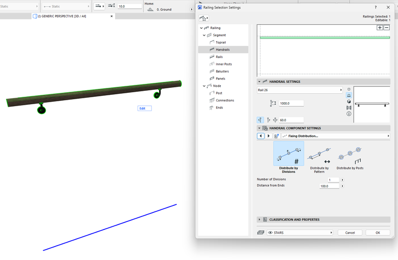

I want a wall mounted handrail, with brackets. 2 hours later, I give up. I am going to do it in SketchUp and import. Pathetic.
A 40mm diameter linear handrail along a wall with 90 degree wall mounted brackets. 200,000,000,000 settings, no idea what they are doing, no result after 2 hours. Each added item results in different materials?
In Archicad, I managed to finally get A railing, with a 150mm overhang (no idea where this is turned off) and floating brackets not connected to the wall. I am not going to embarrass my practice issuing this drawing.

You need to use a Handrail to get wall fixings.

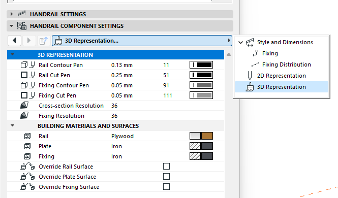

Materials, there is a similar dialogue for each component... There is a wish around for this to be consolidated rather than being across a half dozen different dialogues...

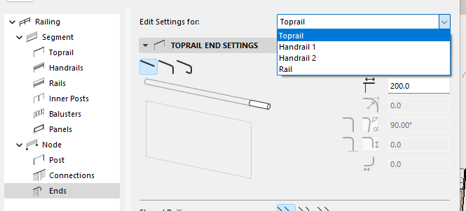

Overhangs
Overhangs
mthd
Hello @CPGQ, you can use the pre made ones already in the library and modify them accordingly.  I agree that some things do take quite a bit of time to create and other software may do some things more efficiently. I know that if I used SU to model railing it would take me even longer than in AC. Never tried it in VW but I have seen some videos and the latest fence tool looks good.

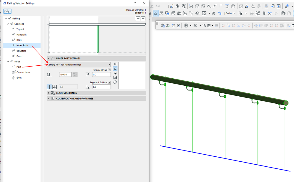

This is correct.
I have also found that you also need to have the main end posts and the internal post turned on to get those fixings to appear.
That is a bit of a problem when you want to fix to a wall and don't want the posts.
Maybe I am doing something wrong when it comes to this?
You can't set the posts to 'None' as the fixing will not show.
You can't make the post invisible by adjusting the height of width to zero.
You can hide the post in the wall.
My solution was to create a post that is actually not there at all - no 3D.
Object is attached - just add it to your office or embedded library.
Then set the posts to the spacings you want the fixings to appear, and use this 'empty' post.
