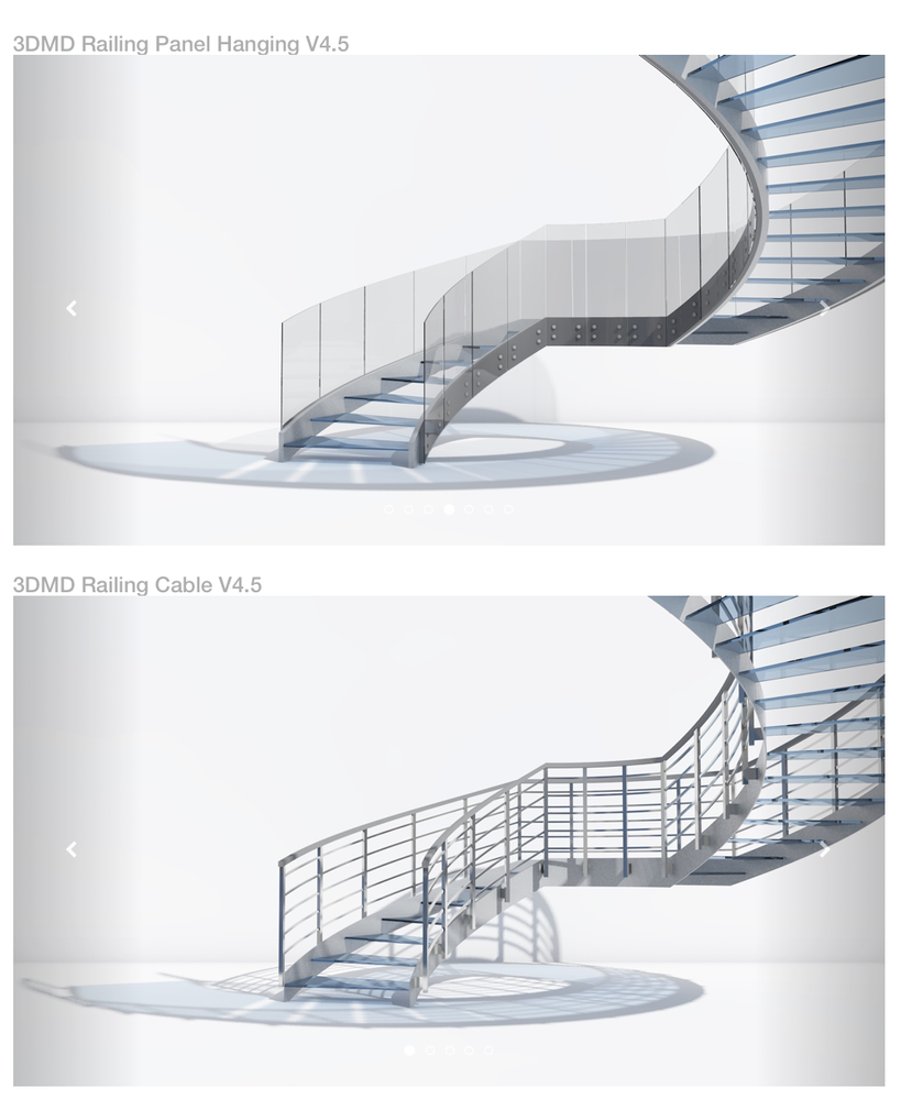

This is the railing tool we should have, this is included by Graphisoft in the Italian version;
http://www.3dmediadesign.it/objects.html

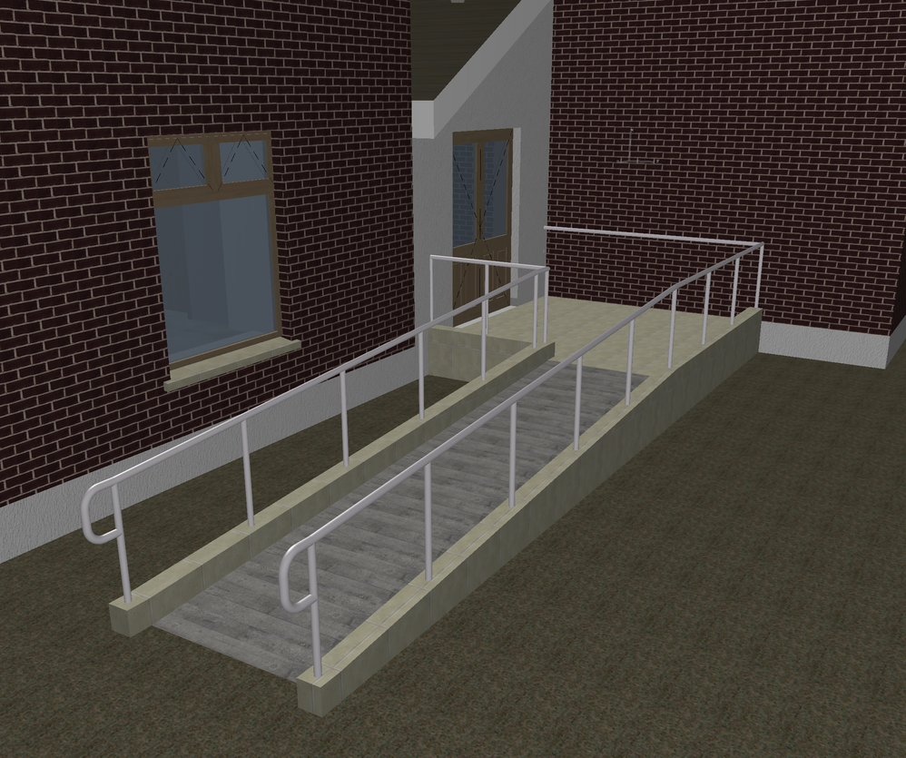

Whereas this took hours of effort and frustration;
Made of roofs, slabs, hidden cutting slabs etc.
All of this is out of the box with the 3DMD tool.
I'm going to download it again to see if it works. It's only $20 per tool. I used a trial of it years ago, then went to Vectorworks and now I'm back to ArchiCAD.

Thanks for that.
Obvious now that you say it. I used a Topsail instead of a Handrail, but 99% of the time, the top rail is the handrail, so this is not intuitive.
