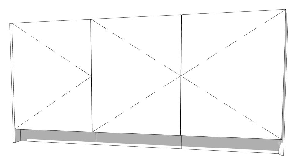

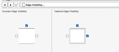

Hi! how do I remove these lines ? It is already painful that archicad cabinetry library is not customizable enough for designers so I had to create 3 cabinets instead just ONE with different segments and types... Finally I build the 3 cabinets (already a painful experience) , now these lines shows everywhere! I turned off everything in setting and it is still there. there are connected perfectly and have same finish, so it should hide the lines.... I tried also different display orders but nope, nothing works.
- Floor plan shows ok, all seamless, the cabinet edge visibility on side is turned on for a reason and must stay however the other side is turned off and should not show anywhere and especially not in countertop and baseboard.. I mean... I would have to literally explain the carpenter, piece by piece please don't make cuts, it's my software... and no not a free one.
- regarding floor plan, note worth saying, that countertop visibility also does not show, neither backsplash is ... also can't see each line to be customized for one or another (cabinetry/drawers openings, backsplash, carsas...)

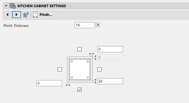

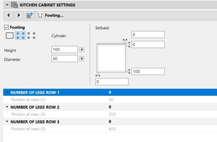

The only work around I've found is to use the Plinth and footings rather than just a 'square footing'. At least it eliminates the lines of the base, not sure how to fix your splash back problem.

Use the plinth as figge described.
If you don't have options to hide the backsplash joins, then I would turn it off and add your own continuous backsplash.
You could do the same for the plinth (kickboard), but we really should have the option to hide all joining edges in plan and elevation when these objects are designed to be used side buy side.

In Archicad, when 2 of the same surfaces in the same plane touch, they will join seamlessly (in elevation/3D).
Unfortunately this does not apply automatically to objects, as they are always 'independent elements.
I am not sure if this is something Graphisoft can fix, but it would certainly help if they could.
