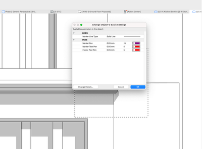

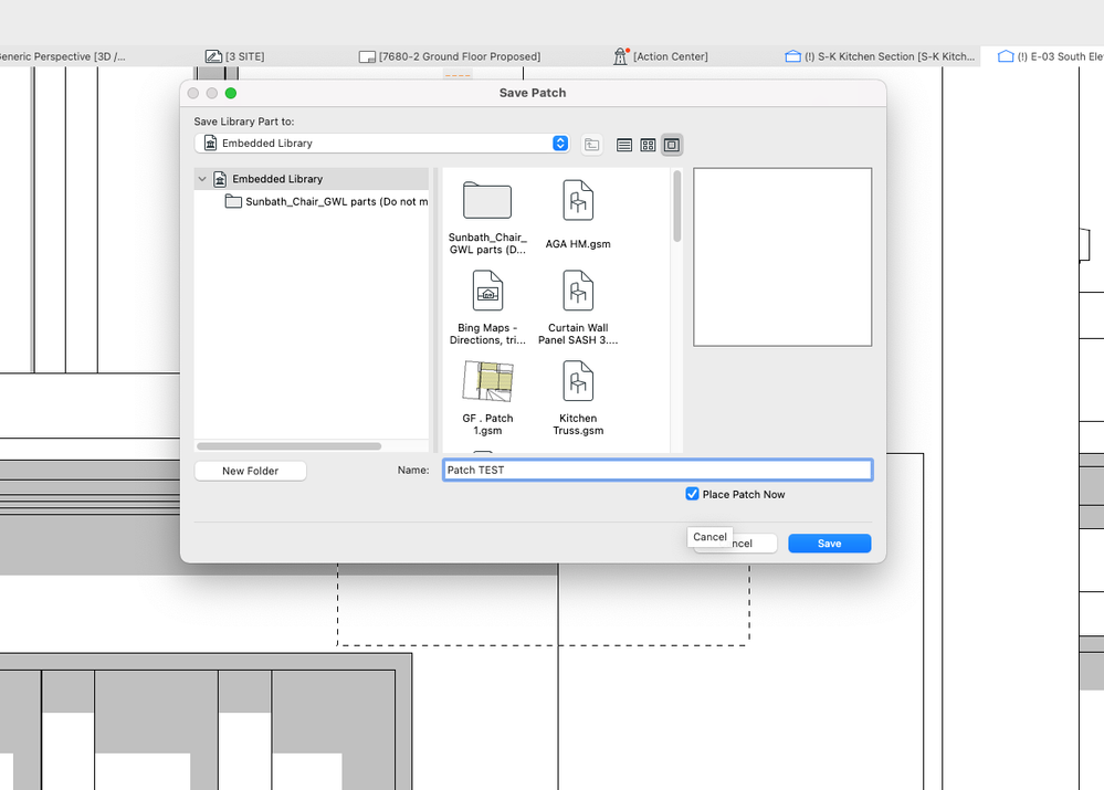

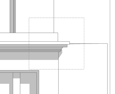

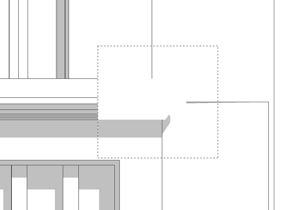

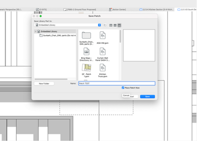

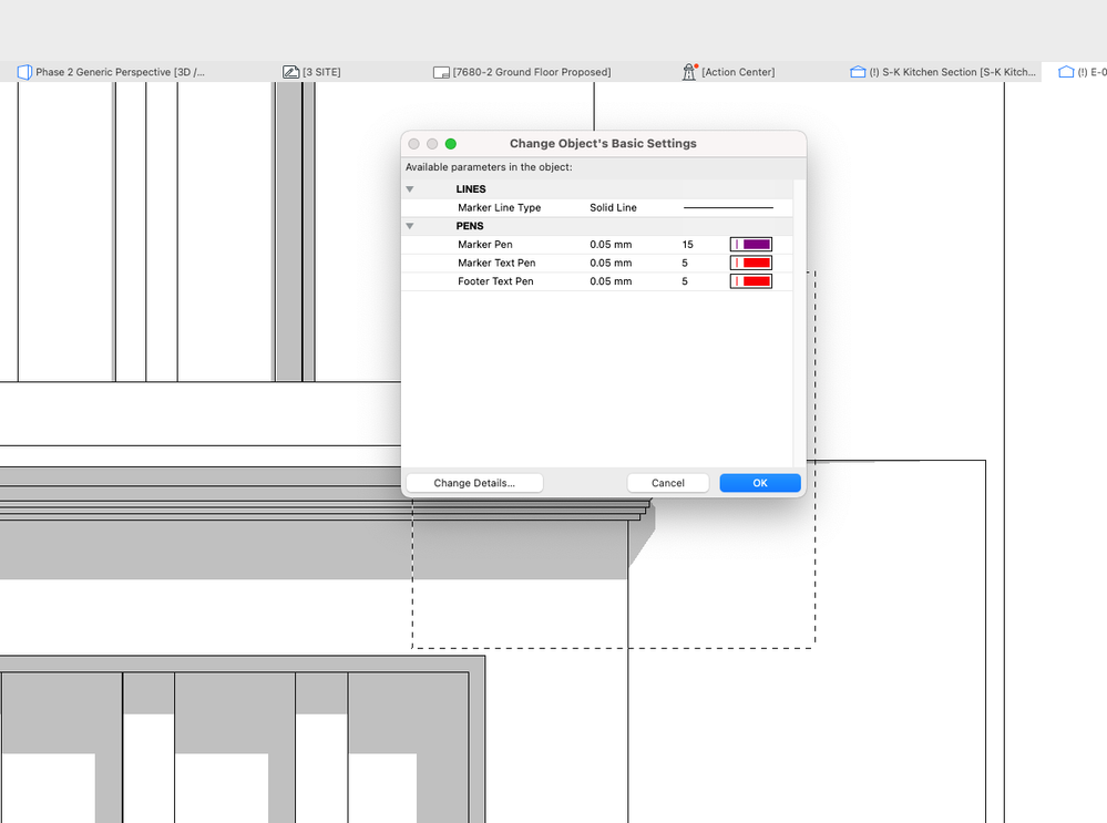

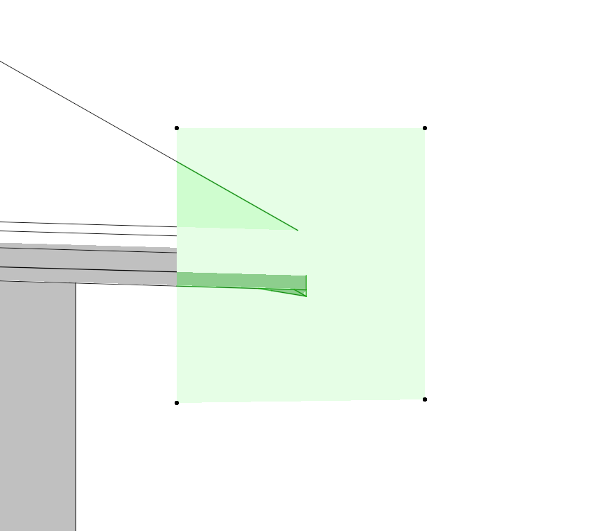

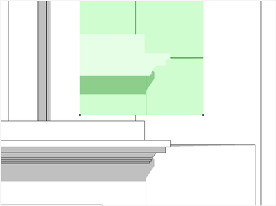

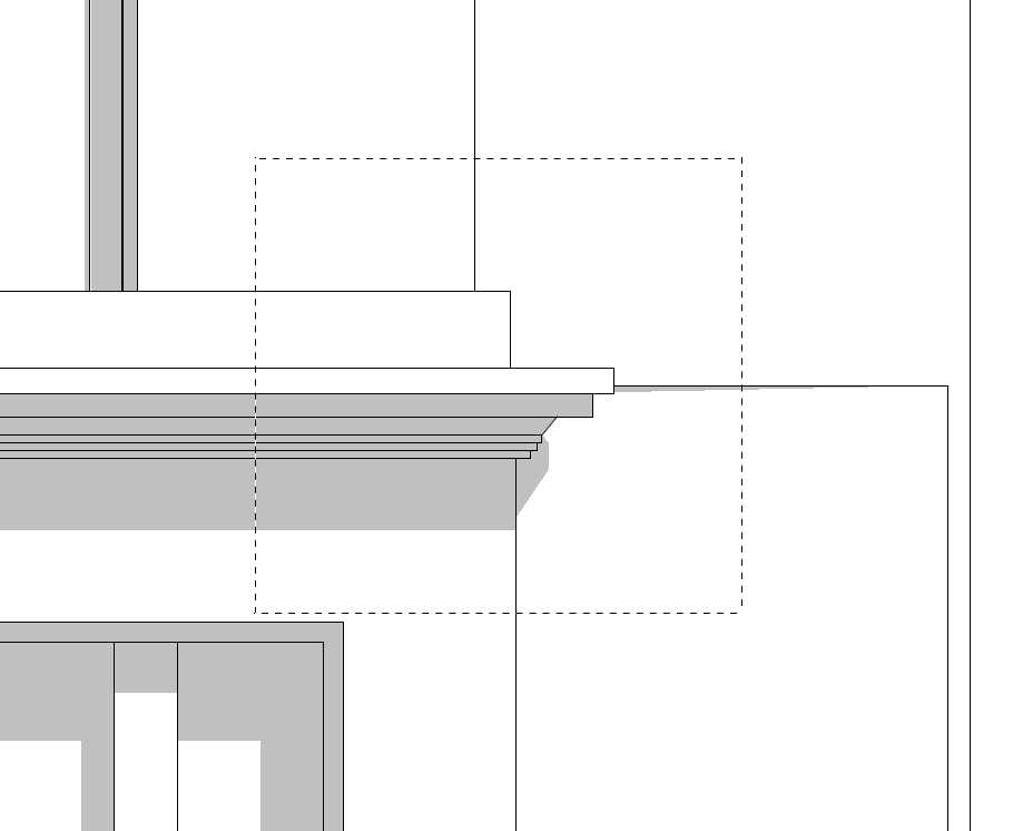

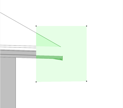

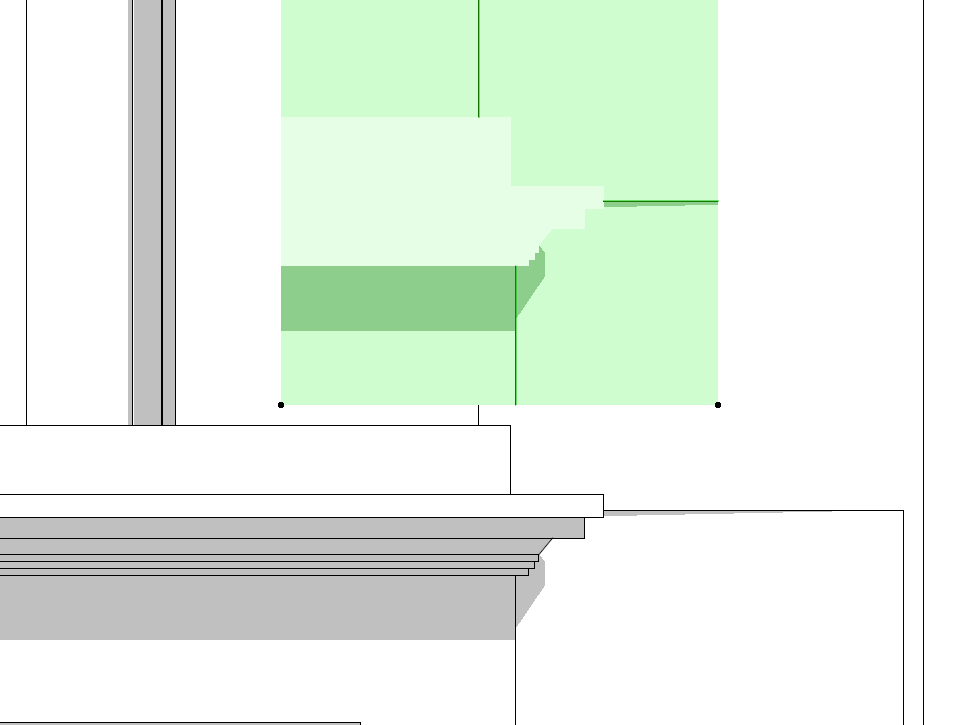

Hi Gurus,
I have had this issue for a while and I can't figure it out,
When using the patch tool to clean up some details on elevations, it will completely ignore any beams or complex profiles, Im not sure if it is just beams and complex profiles but that's what I have noticed it on.
Using latest 25 build.
Much appreciate any enlightenent!

Our developer has confirmed that this is indeed a bug with the Patch tool. The problem is that the patch generation draws the beam and column elements, but does not draw the segments of them. The visible parts would be drawn with the segments, not the main elements.
I entered the defect as DEF-7192. Hopefully, it won't be a difficult one to fix.
