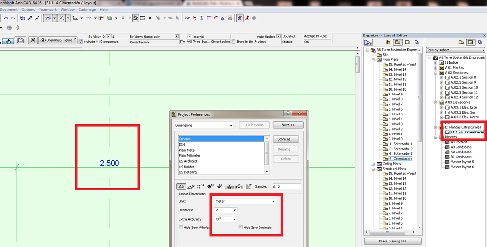

I'm trying to publish some plans from a school project in archicad 16, i change the Dimension settings in the project reference window to 2 decimal points, the issue is that when i try to publish the dimension settings resets to 4 decimals points. How can i publish a plan with just 2 decimal points instead of 4? Thanks

I think the attached image should explain what you need to do.
