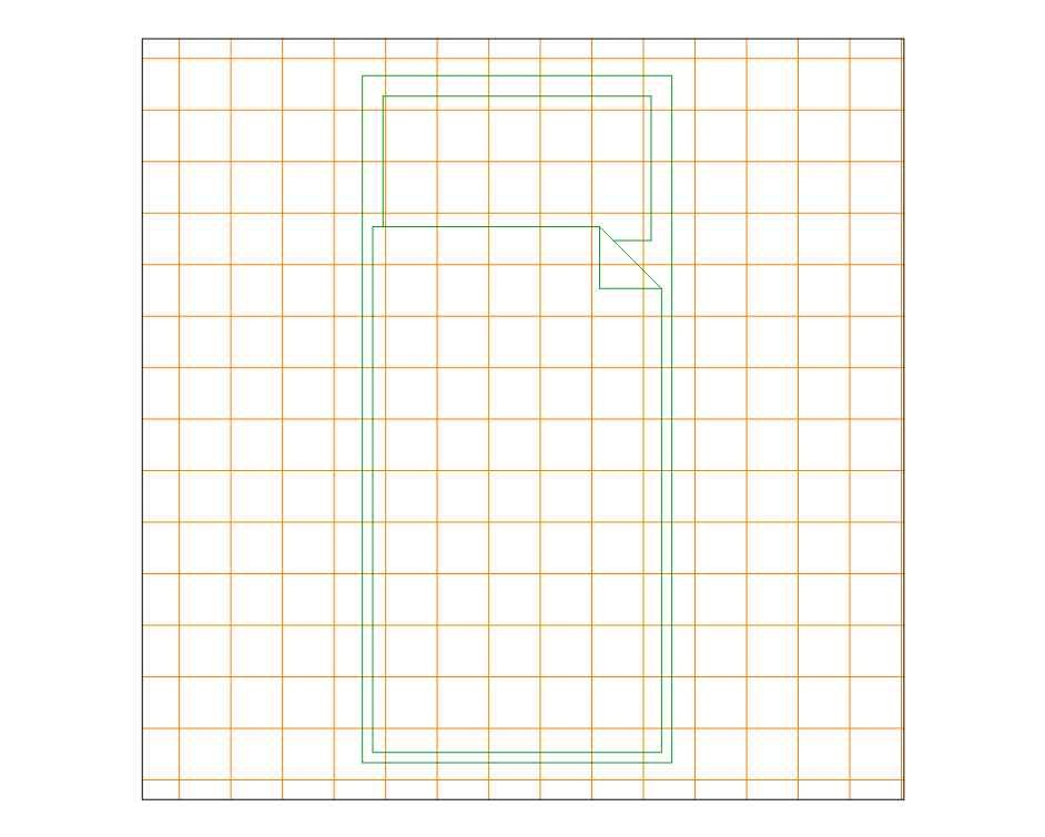

Hi! I have a problem viewing PLT files created with AC10.
I have a tile raster under an object and then I make a PLT archive for plotting
when I open the PLT file with AC10 I get the raster over my object.
I never had this problem with AC9. Any solution please?
PS.: Im posting an image
2 REPLIES 2
You might have the background set to transparent in the object dialogue. Check thats it's set to solid and use the white cover pen - usually pen 19 in the standard Version 10 pallettes.
well ther is no trasparent background on my object an I use pen 19 for my background. the strange thing is that if I insert the PLT filethrough Drawing tool everything looks ok but when I open directly the PLT file then I see the problem.
