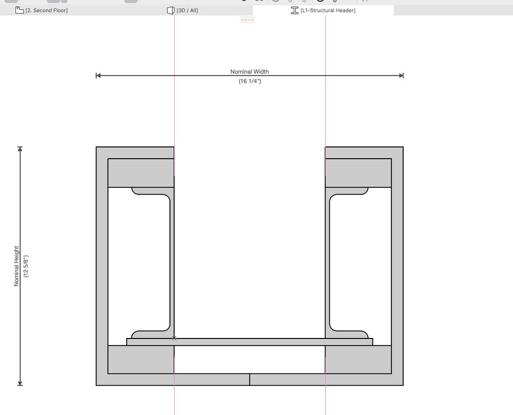

Profile Manager Edit Window shows all elements with the same gray fill
This has happened before and it cleared up. I don't remember how. But this is global for all profiles. It is like a graphic override is in control, but I cannot find a way to change it back.

Hello Todd,
I'm very sorry to hear about the issue!
In Profile Manager only the Fill Type has effect on the fills, no other settings are available here.
The fills can only be chosen from the Building Material fill list. I'm wondering if those are set correctly?
Maybe the cut fill of those elements were set to gray or maybe they are missing fills.
I suggest checking this in 'Options' > 'Element Attributes' > 'Building Materials'.
