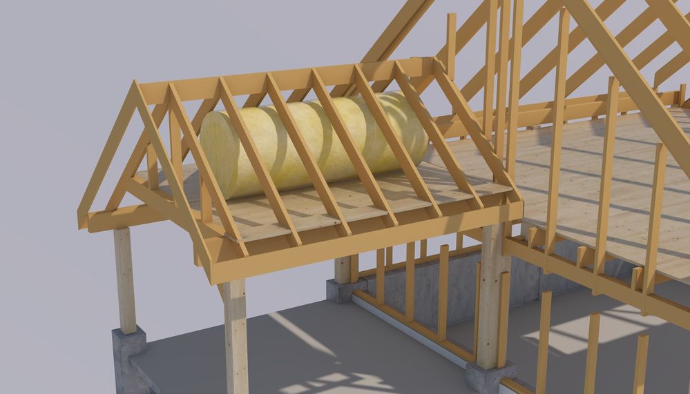

Could someone please explain why the image of the water tank wrapped in a fiberglass insulation is distorted/corrupted in Redshift renderer (lighter image)? 'Standard' renderer generates the image correctly (darker image). Plus, the Redshift renderer makes the image over-exposed seconds before its image generation ends. Thanks in advance for any insights.

Hello,
I consulted with the developer and it turned out that the issue comes from the Alpha channel. In the Surface Settings, if you disable the Alpha channel, the Insulation Fiberglass surface will be rendered without the corrupted stripes in Redshift.
I hope it helps you with the problem. Feel free to ask if you have any further questions!

Hello,
Thank you very much for the questions and I am very sorry for the issues!
Our developers are aware of the problem with the Insulation materials already. In this case, the same layer parameters are used twice (in Color and Bump also). I will ask for a workaround in this case.
When Redshift finishes the render, it will apply an extra finishing step to brighten the scene. This can be configured by checking the Detailed SettingsPhotographic Exposure. This option works somewhat similar to a camera, so you can see something like shutter speed, aperture and ISO. If you find the scene to be too bright, you can adjust these values, or disable it completely.
I will let you know once we learn more regarding the Insulation materials.

Hello,

Settings like in a manual camera work well (nostalgic...). Problem fixed. Thank you.
