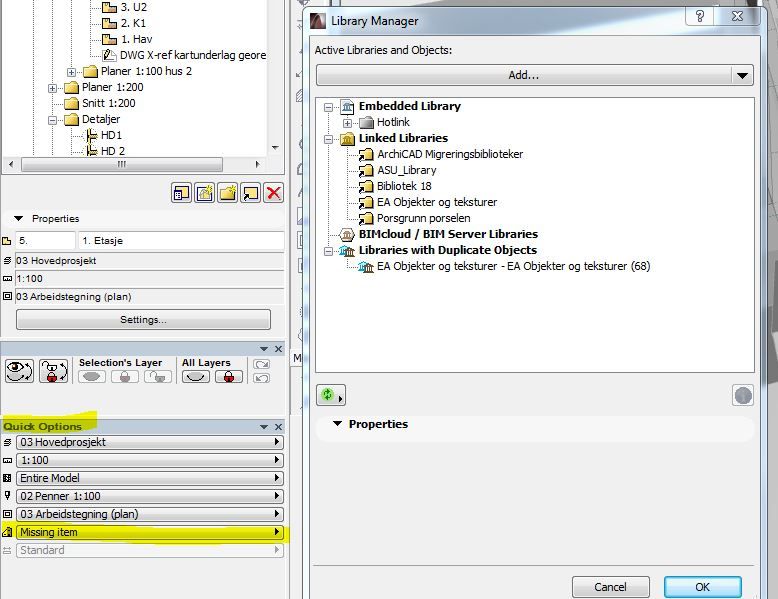

Renovation filter "missing item"
Have anyone seen this before?
"Renovation filter: missing item"
2 Replies 2
Maybe you have deleted the Renovation Filter that was part of a saved View and after you activated the View it cannot apply that Renovation Filter because it has been deleted. You may have to redefine your saved Views in that case.
From the Renovation Palette in the Renovation Filter field select the Renovation Filter Options from the drop-down list.
In the appearing Dialog you should have at least one Renovation Filter listed in the list in the upper left list.
In the Quick Options Palette can you select another Renovation Filter from the ones available?
The problem fixt it self after reopening and reloding the hotlink.
I was not abel to choose another renovation filter.
