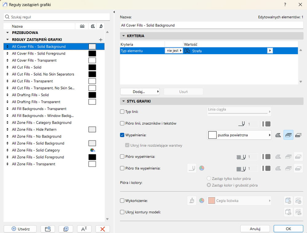

One of my project  start crashing after trying to change anything in Renovation Status (RO) setting.
I Started digging and find out that in Graphic Overrides Rules, Renovation tab is empty.
It happend only in one of my files.
Archicad 28 POL
Windows 11
3 REPLIES 3
Is this a file you migrated from an earlier version? If so, what version was that and also was it POL localization or possibly some other one?
What happens if you close the file, then open it, and check the "Open and Repair" option in the Open Dialog? Does that bring back the Renovation options? They should be there, so the fact that they are not there indicates that something is not right, maybe some kind of file corruption, maybe something else...
Yes, file is migrated from template created in AC27 POL.
I tried "Open and Repair" and it didn't help. Still crashing after open Renovation options, and overrides rules still are missing.
