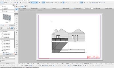

The roof was showing yesterday, but now it is missing. It shows up fine in 3D and when I work on the roof storey.
EDIT: Solution in case anyone gets the same problem. At the place I was in the picture, right-click the house. Then click on "Modify Source View Settings". Then change the Layer combination to 3D Documentation/Visualization.

Hi. Did you insert this drawing into the layout from the view map or the project map?  If you did the latter you will keep getting it changed.
Kenneth
Can't remember, I think View map. Is it supposed to come from Project map?
Hi, no, from the view map
