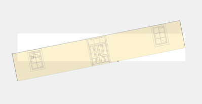

Rotated elevation view
HELP! The elevation is rotated! It is a Teamwork project, I tried to delete the local data, sign in and off. Everyone in the project has this view. The copied elevation looks the same, the new one is okay.

Please state which version you are using! Maybe put it in your signature, so it's easier to help you.
This was a known bug, that should be corrected with more recent versions. Did you install all hotfixes?
At least recreating works. It might be a bit of work, but back in the day I also found this the only reliable method.
You can also try to let everybody leave the TW file, taking it down and repairing, delete all local data for all team members, and then reupload.

Thanks, we are using the AC 27 6020 version in this project.
