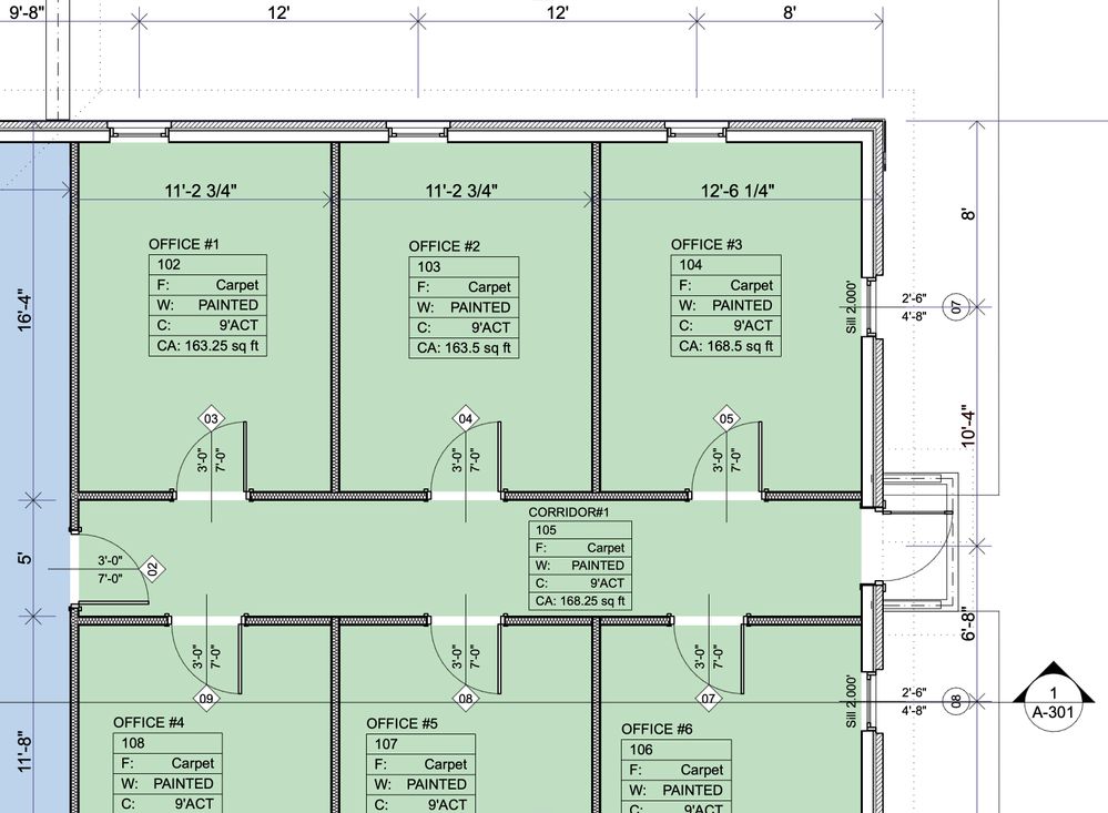

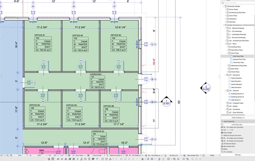

Working on a project and in the model plan view the text for the doors and windows are all shown(see Model view). When I go to plot the plan they randomly disappear(see plot view)

It can't be an MVO setting because some markers show and some don't.
I am thinking it might be renovation filters.
Do the doors/windows or maybe the wall all have the same renovation status?
I don't have Archicad running at the moment to test.
I am wondering if there is a setting in the reno filters to show/hide the markers.

Bob Moore
I went back and changed some of the filter settings and solved the issue.
I'm still not sure why the setting differed on the elements . The door and window elements were all placed at the same time and were the same elements.
