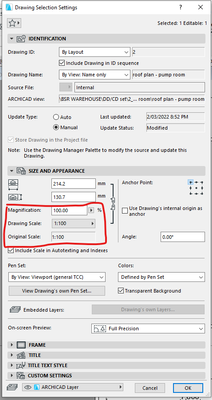

My drawing keeps changing back to 1:100 between the drawing and the PDF from 1:50 but only in relation to the text. The drawing stays the same size. I change it in the drawing to 1:50 and the text is the right size. Then I go back to the pdf and the text is big again.
Any ideas?
1 Reply 1
Gerry Leonor
when you open the drawing settings, is the Magnification set to 100%
because if not, your Saved View is set to one scale, but your placed drawing is set to another.
it's best to control the look of the placed drawing in the View Map, rather than in the Layout Book.
