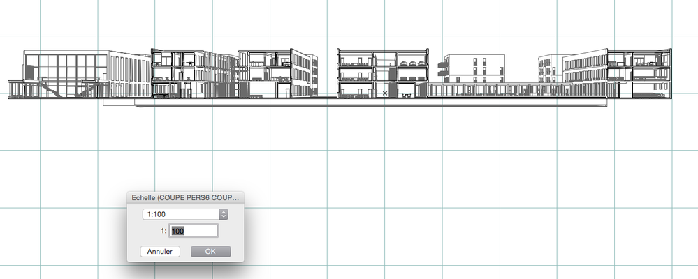

I've already done what you said, here is a screenshot of my 3D section. I want a scale of 1:100 for the section, and when I want to save my document as pdf, it's 6 time smaller, completely out of scale. I know a 3D document doesnt have a scale, but here what im doing is a 3D section, and a section has a scale.
Ive asked around me and people tell me "just do an axonometric section", or "scale it on psd"... but i imagine there must be a way ??

A perspective view doesn't have a true scale. You could resize it for your cut elements to be roughly on scale, but it would not relate to the 'scale' you input for the drawing.

This is really one the best options for now.
If you want to keep it in ARCHICAD, I'd say "scale this 3D section in the layout". Let us know if you need help with layout scaling, but I think you got it.
