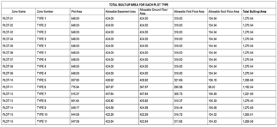

I've made some custom Properties (with expressions) for a masterplan project and now I'm trying to put that into a schedule. There is a description to each property and I want to include that in the schedule. Is there a way to do this? I've attached screenshots of the description and the schedule.

The property description field is not available to schedules. However, you can get this information via the Python API and the function GetDetailsOfProperties. Then add the information to a custom Property which would then be available to the schedules.

Thanks, Poco. I will try this later on as I haven't worked with Python before.
